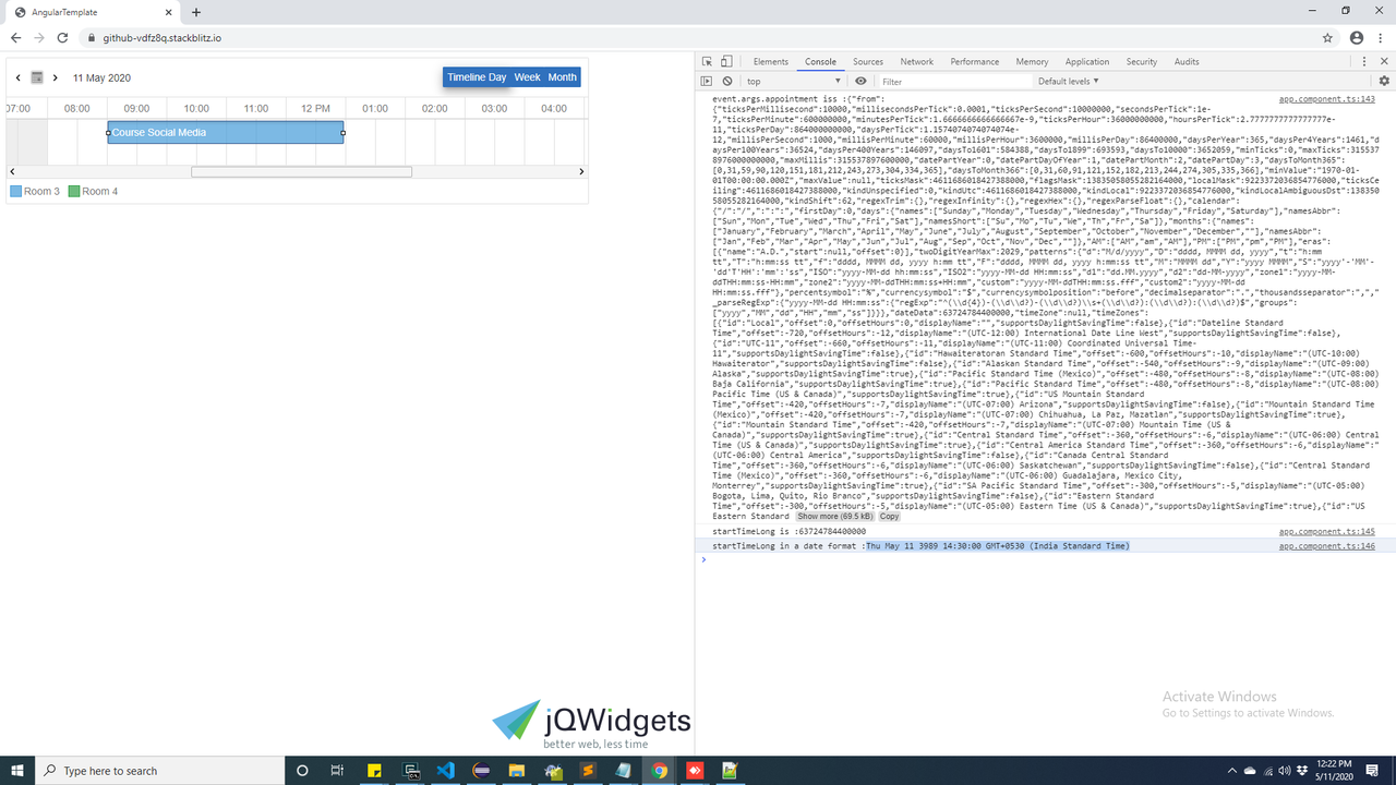

I’m currently working with the jqxScheduler, and trying to update the appointment by the drag option which triggers the onAppointmentChange event with the appointment details.
here i’m trying to use the ‘from’ property which have the date value.
“event.args.appointment.from.dateData”
So, is it a correct way to have ‘form’ value?
because i have re-assigned the appointment and for the ‘form’ value i have set 11 may 2020 9 AM. but i’m getting different value.
Here is the screen shot https://i.postimg.cc/6575dJ9C/on-Change-Appointment.png
and is my sample code https://stackblitz.com/edit/github-vdfz8q
Thanks you

PeterI am not changing any appointment fields. I am changing the appointment time through scheduler drag and drop UI
I am getting the event from the drag and drop (onAppointmentChange).After this, I don’t know how to get the proper ‘from’ and ‘to’ date and time.
Please see my screenshot attached and stackblitz example.
Please see the highlighted date that is shown through console.log in the above screenshot.
Thanks

PeterHi Peter,
i followed your suggestion and modified my code.here is my modified sample code https://stackblitz.com/edit/github-rnaphv
but still i’m not getting the correct value of changed appointment ‘from’ and ‘to’
In below screen shot i have logged the ‘from’ value in long and string format
so,whatever date value is coming in string format i want that in a long format.Here is the screen shot https://i.postimg.cc/7P7ZvkYd/on-Change-Appointment.png
Thank you
ShiviHi Shivi,
Seems like you did not follow my suggestion. toDate() method of from and to returns Javascript Date object i.e: https://developer.mozilla.org/en-US/docs/Web/JavaScript/Reference/Global_Objects/Date. Using the JS Date API you can format it to whatever you need.
