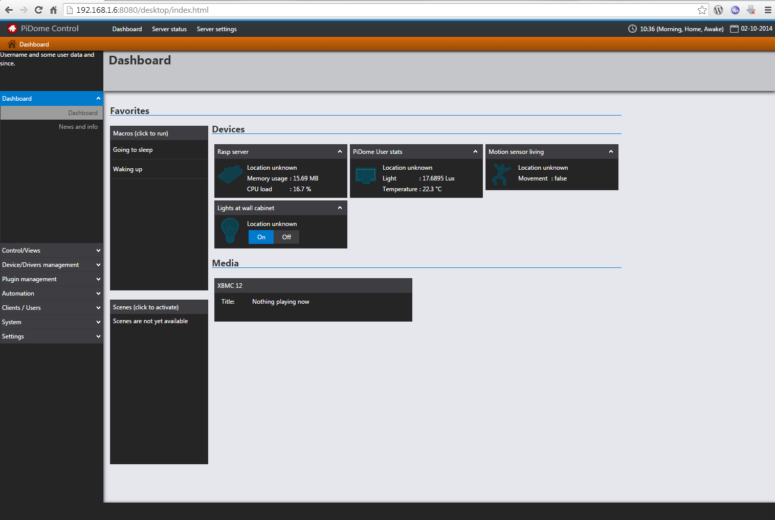

    Which produces the blocks as seen in this screenshot (The upper part below the devices header):
    Blocks

    Invalid json #60599
    PiDome
    Hi Dimitar,
    I will try the above and will report back, thank you.
    John.
    Invalid json #60601
    PiDome
    Hi Dimitar,
    I think i have found the issue. My docking is loaded not in the head but in the body after a async call to the getFavoriteDevices. This function is dynamic in the way that users can add/remove their favorite devices which will cause this rpc call to have a entry added or removed.
    I have tested it with 3.5.0 and it now works only when i use custom device id’s on the windows, which is logical due to the application setup, so it is clear to me now. When i add a new favorite device (new block). All goes fine the moved blocks are put where they are supposed to and the other blocks are shifted according the rpc call output order. So that’s good!
    But, here it comes, when i remove a device, so a specific window id is not present, i get the popup again about an invalid json. This is a kinda misleading message because the json itself is not invalid, the json is correct, but the docking just can not find the window id stated in the json.
    So yes, it is working, but, i really really really need to get rid of this alert box in a graceful way so it just skips the not found window id and it continues with the the window following up.
    If i have to hack and slash my way through the code i won’t mind. This dashboard setup has been presented during JavaOne this week. So when i release an upcoming version i really need to get this up and running without errors. So if there is any option to discard a non found id you will make me very happy. If there ain’t such an option could you please point me to the location where i can suppress this message and let the docking continue it’s work?
    Invalid json #60607
    Dimitar
    Hi John,
    Please contact us by e-mail at support@jqwidgets.com where we can discuss the matter further.
    Dimitar
    jQWidgets team
    http://www.jqwidgets.com/
