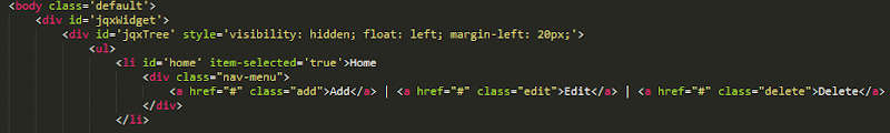

    Dear Team,
    I wanna replace context menu by navigation menu for each node like this
    Navigation menu link
    but when I add my code outside LI tag
    Code outside LI tag
    Result 1:
    Result 1
    when I add my code inside LI tag
    Code inside LI tag
    Result 2:
    Result 2
    Please help me some idea or solution in this case.
    Thank in advance!

    Hello bernyrian,
    Here is how you can achieve this layout. However, we do not recommend doing this at all, because it ruins the proper HTML structure of the jqxTree and as a result unexpected behaviour may occur when using its API.

    Berny Rian
    Dear Dimitar,
    Thanks for your reply, but your solution isn’t fit as request.
    Dimitar Solution
    Do you have any better solutions? or how can I update this request into API jQWidget? Is it possible?

    Hi Berny Rian,
    I think you have not applied the CSS exactly as I have given it. Nevertheless, we cannot provide you with any other solutions on the matter because what you require is not supported by jqxTree.
